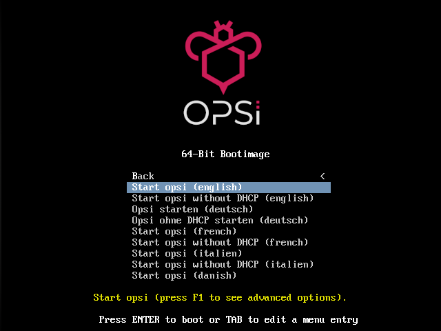

You can find an ISO image of the boot CD on the opsi Tools website. Download the image and burn it to a CD. Then, boot the computer from this CD. The installer will welcome you with the following boot menu:
The Boot CD shows the following Boot Menu.
Figure 2. The Boot CD shows the following Boot Menu.

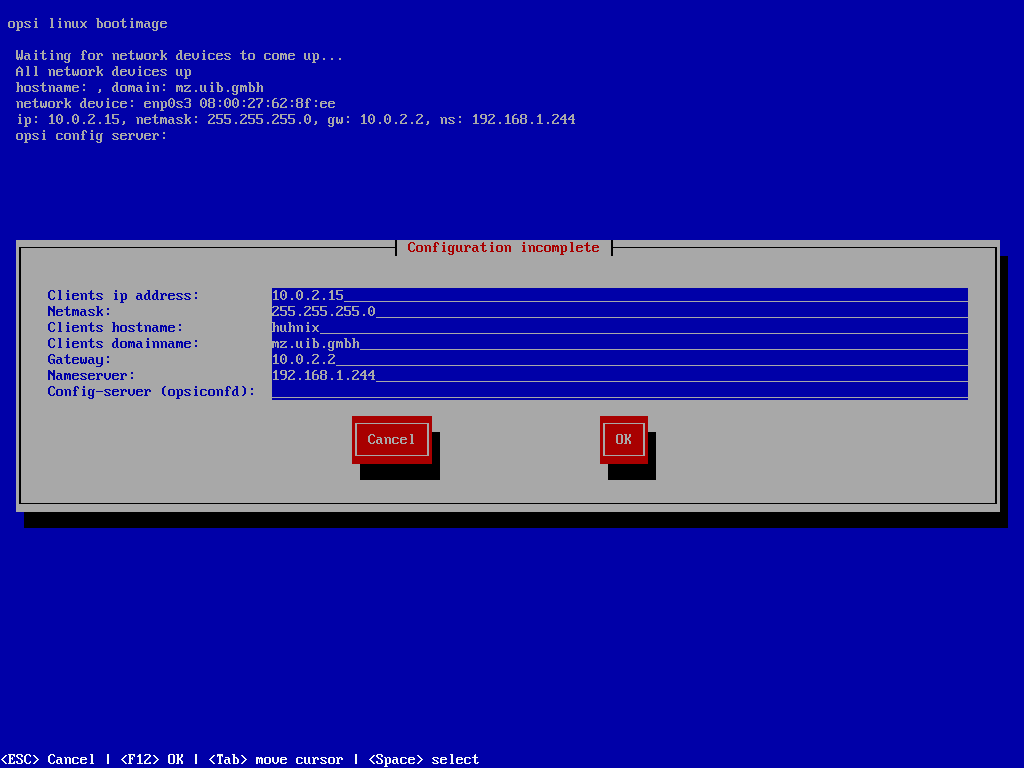

Select Start opsi (english) and press the [Enter] key. After a while, a dialog box will appear in which you should enter the IP address of the client, the network mask, the hostname, the domain name, the gateway, the DNS server, and the IP address of the opsi config server (optional). If your DHCP server assigns IP addresses to unknown computers, some of these fields may already show valid values.
The Network Settings for the new Client
Figure 3. The Network Settings for the new Client
Use the [Tab] key to navigate to the OK option and then press [Enter].

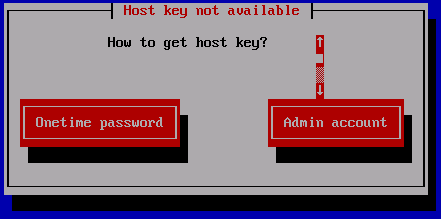

How should the client register with the opsi server?
Figure 4. How should the client register with the opsi server?
Select Admin account to enable the client to log on to the opsi server and create itself. This process will be authorized in the following step.

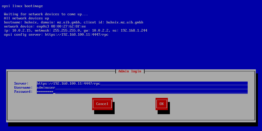

Authenticate on the opsi server.
Figure 5. Authenticate on the opsi server.

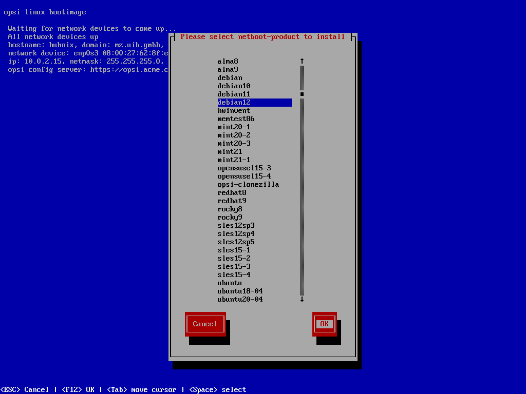

Enter the username and password for an account that is a member of the opsiadmin group (refer to chapter Authorizations for details). Upon successful login, the client will automatically transmit its data to the server, creating its record. You’ll then see a list of available Netboot products. Select the desired products for installation using the space bar.
Select a Netboot product for Installation
Figure 6. Select a Netboot Product for Installation
You can now choose either the operating system you wish to install or opt for hardware inventory.
