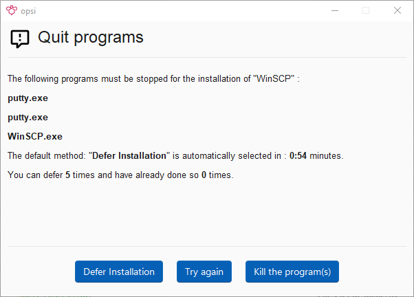

  9. The user dialog is displayed.
    If there is no response from the user within the DIALOG_TIMEOUT (usually = 60 seconds), the DEFAULT_ACTION (usually = defer) is selected.
  10. recheck selected
    If recheck has been selected more than MAX_RECHECK (3) in succession, the option recheck is no longer offered and the DEFAULT_ACTION is now MAX_RECHECK_ACTION (defer).
  11. defer selected
    If defer has been selected more than MAX_DEFER (5) in succession, the option defer is no longer offered and the DEFAULT_ACTION is now MAX_DEFER_ACTION (kill).
  12. kill selected
    If kill is selected, opsi-script shuts down the interfering process(es) and the action request is continued.
Dialog: `Quit programs`
Figure 1. opsi-setup-detector: Dialog: Quit programs

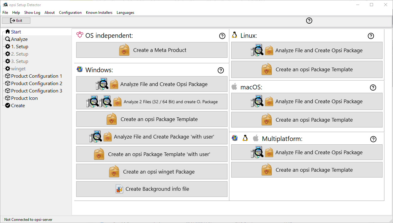

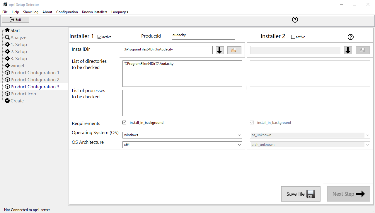

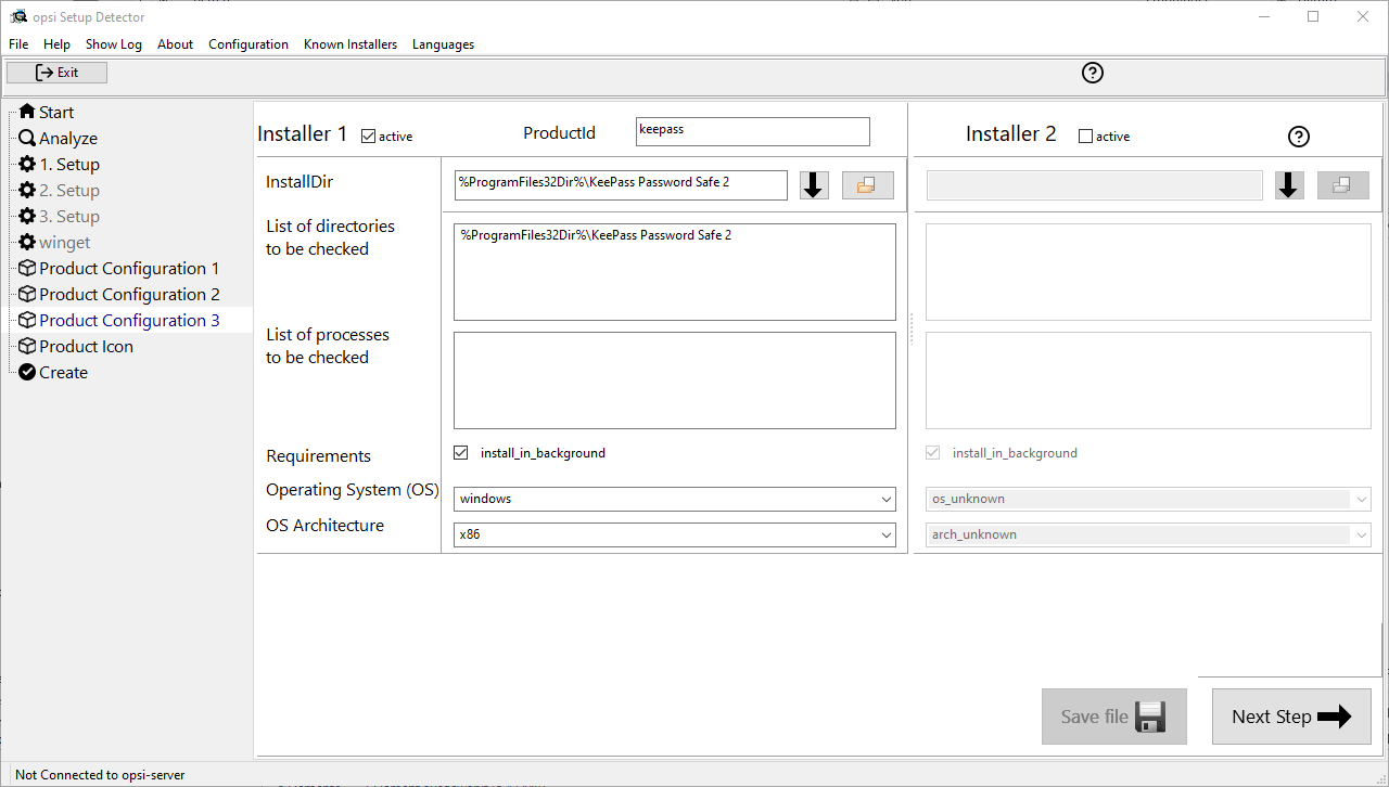

Creating products with background metadata
The opsi-setup-detector from version 4.3.6.x supports the creation of the metadata required for the background installation. Until the official release of this new extension, the corresponding functions of the opsi-setup-detector are deactivated by default and must first be activated via the configuration. This is done by activating the config:
EnableBackgroundMetaData :
Activates the background install support: Shows the Background Info File button on the start tab. Makes the Product Configuration 3 tab visible and usable. Writes an opsi-meta-data.toml file during product creation.
After checking the box and closing the configuration dialog, you have to restart the opsi-setup-detector or change the language to reload the interface.
After successfully activating the background install support, you will be forwarded to Product configuration 3 after Product configuration 2, which displays the metadata to be saved.
Product-Background Info
Figure 2. opsi-setup-detector: Product-Background Info
  • In order to generate metadata for a setup / installer file, the Installer 1 Active checkbox must be ticked.
  • The InstallDir field refers to the directory in which this software will be installed. If it is not yet filled in correctly, this can be entered here or selected using the selection button next to the input field.
    The InstallDir can be copied to the List of directories to be checked via the Down arrow button.
  • The List of directories to be checked field is a list containing one directory per line, which can be a source of critical processes. Usually only the installdir is listed here.
  • The List of processes to be checked field is a list containing one process name per line (with or without path), which can be a critical process. Usually there is nothing here.
  • If both lists are empty, no running processes are checked and the software is installed directly.
  • If there is a checkmark next to install_in_background, this means that this product may be installed in a Background Install Situation. If the check mark is removed, the product may not be installed in a Background Install Situation. Reasons for this could be required reboots or other side effects that cannot be handled.
  • The Operating System (OS) should always be set to windows. The extension opsi-background-install is not active for other operating systems.
  • The specification OS architecture indicates the architecture of the required operating system.
    Allowed here are x86, x64, arm64, arch_unknown. The requirement x86 is also fulfilled on an x64 Windows operating system. The requirement x64 is not fulfilled on an x86 Windows operating system. The arch_unknown requirement is always fulfilled.
If everything has been filled in correctly, click on the “Next step” button to exit the screen. The metadata file is automatically created when the OPSI product is created using the Create Opsi Package button.

The opsi-setup-detector from version 4.3.6.x offers the possibility to supply simply existing products with the required metadata. To do this, check the EnableBackgroundMetaData box in the configuration window (see above). Then the button Create Background Info File will be visible at the bottom of the start page. This is used to subsequently supply existing OPSI products with the metadata file.
Start page with button Product-Background Info
Figure 3. opsi-setup-detector: Start page with button Product-Background Info
If the Create background info file button is pressed, an attempt is first made to determine data about the existing product via . For this purpose, an opsi-setup-detector project file (*.osd) is requested. You can cancel the dialog if such a file does not exist. In this case, you will be asked for an existing control file (control, control.toml). You can cancel the dialog if you do not want to use such a file or if it does not exist.
The information from the project or control file may be used to detect the operating system architecture and the package number.
The Product Configuration 3 screen is then displayed.
Figure 4. opsi-setup-detector: Product Configuration 3
The mask is filled in exactly as described in in the previous chapter.
If everything is filled in correctly, select the CLIENT_DATA directory of the OPSI product via the Save file button and save the opsi-meta-data.toml file there.
In this case, the package number of the product is also increased by one and an entry is made in the changelog.md.
The product must then be rebuilt (opsi-make-package) and installed.
The metadata of the OPSI product is now available.
