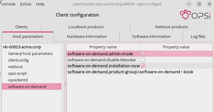

Configuration for a single client
The configuration for a single client - or client specific configuration - is useful if, for example, only some of the clients should have access to the Software-on-Demand extension. Or if you want to make several product groups available to some clients.
The configuration of the client specific host parameters can be edited in different ways:
The most comfortable way to edit the configuration is via 'opsi-configed'. Choose one or several clients (even all clients of a client group if you want to) and then navigate to the tab "Host parameters".
configed hostparameters
Figure 3. edit hostparameter in the configuration editor
This editing overrides the system wide defaults.
